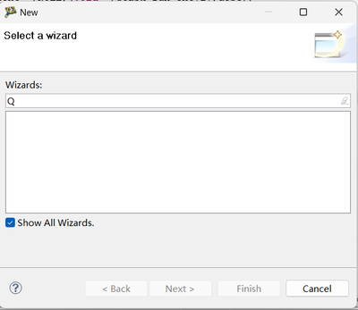

There is no Qoriq Configuration Project for choice while create a new Project in CodeWarrior
2,365 Views
wangjk
Installed Products:
- CodeWarrior for Power Architecture
Version: 10.5.1
Build Id:160128
what's the problem?

I have uploaded QCVS for PA 4.5 installation file here.
https://support.nxp.com/s/case/5002p00002vT0raAAC/community-there-is-no-qoriq-configuration-project-...
Please install this packet from Help->Install New Software->Add->Archive in CodeWarrior IDE.
