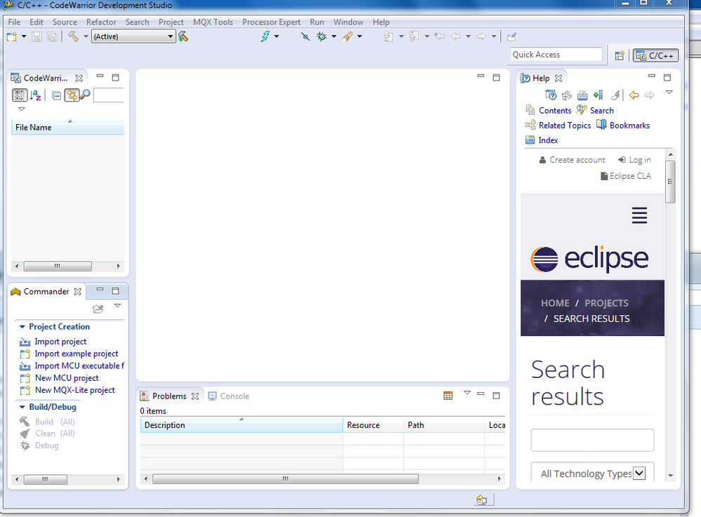

That leaves Option B, which states, "In Eclipse CodeWarrior,  user can also set the search path for head files and libraries. For head files, please set its search path from <Project> Menu->Properties, then go to C/C++ Build-> Settings -> HSC08 Compiler-> Input.".  However, I'm unfamiliar with Eclipse CW and you haven't described how to access the 'Properties for hcs08a' and I don't see it available anywhere across the available tabs or their sub-menus.  Have you left something out in getting there?  Am I to specify/open the original .mcp file of the legacy CW project?
Here's what Eclipse CW presents to me -
Please provide details on how to proceed from this point.

Option A, the MCU change wizard and classic importer wizard are removed from CW MCU v10.3 because these wizards only worked for the simplest projects – projects using the default settings.  Now, the Project Importer in v10.6 only supports DSC products. I’m sorry for this inconvenience.
Option B, please first open your project for hcs08, and then click on the <Project> Menu->Properties.

jes
Something missing again.
I did Option B above by opening CW 10.6.4, chose File->Open File, selected the original .mcp file from the legacy HCS08 project.  This resulted in CW 7.30 IDE associated with the ColdFire MCU (I have an existing project for ColdFire that I'm using CW 7.30 for) opening up.  I'm not offered ability to 'click on the <Project> Menu->Properties'.
Is there a faster way to find a solution to this?  This back and forth consumes days.  You have no phone support?

TICS_Fiona
Hello Joseph
.mcp file is the Classic CodeWarrior Project, and cannot be opened directly in Eclipse CodeWarrior v10.x.
The Project Importer in v10.6 only supports DSC products.
For other products, the solution is to create a new bareboard project in CW10.6.4, and then add/copy all your source files to the new project. This is the cleanest way to import a project. Below is an application note for how to do this:
