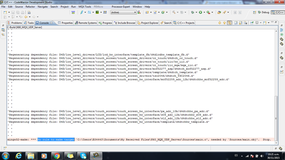

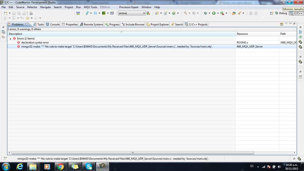

hello, i have a problem.
in this problems section mark
in consola mark
I need help

"no rule to make target" means that the make file does not find the file or does not know how to make it.
No rule to make target | MCU on Eclipse
Have do done a Project > Clean already?

Download an4644s, change settings and this is what appears
