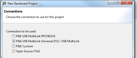

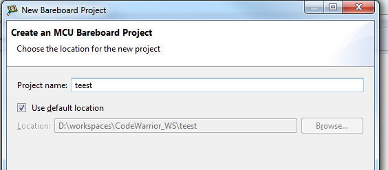

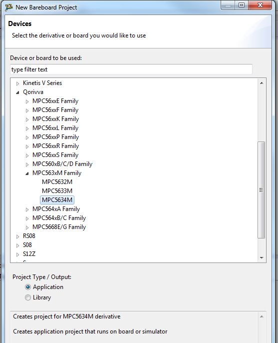

4- Created a new Bareboard project with the following steps shown:
     A)
     B)
     C)
     D)
