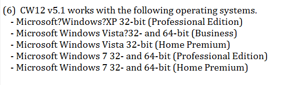

Hi all,
is it possible to use the USBDM (I have a Wytec unit based on PGO's JS16 USBDM-SWD design
with 4.12 Firmware) under Window 10 home editions OS and Codewarrior 5.1 for HCS12?
Any help will be very appreciated.
Thank you all.
USBDM-SWD
2,324 Views
Hello Coti,
From the the CW 5.1 Release , we can see that the CW 5.1 not support the Win 10.
Hope it helps

Also use CW5.2 and add your missing devices using this
Add missing derivatives to CodeWarrior 5.2 (Unofficial Method)
CodeWarrior HCS12(X) 5.1 Windows 10 x64 Install and Update USBDM - YouTube
Check out this video, the steps are pretty much the same for 5.2.
