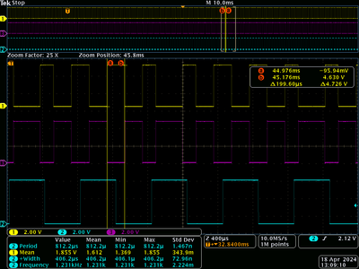

I'm working on an old software that control a three-phase motor with a scalar control approach (open loop), based on the application note AN1857 (attachments). The principle is to loop through a sine wave (with its third harmonic) look up table each 0.4ms (2.5kHz) and output PWM signal describing this sine wave with the good duty cycle. I would like to generate a 220Hz sine wave with 2.5kHz carrier frequency => 11 points for the whole signal.
III. Problem description
When I see the 6 PWM generated on a scope, I notice an inconsistent duty cycle. So, I try a simple approach to test PWMMC's configuration with only 2 duty cycle values (250 and 500 corresponding to 25% and 50% duty cycle respectively).

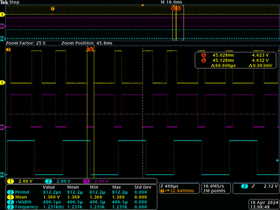

However, when I ran this code, the PWM output does not work as I expected :
  • I have 2 times the same duty cycle for consecutives pulses (I expect an alternating between the 2 values)
  • An inconsistent duty cycle is present and not in the simple dummy table
On the next figures, the yellow signal is the High PWM and purple signal the Low PWM. The blue one is just a port that I toggle in the PWM interrupt to show the center aligned mode.
Figure 1  : Duty cycle of 50% OK, but the next pulse is 50% too
Figure 2 : Duty cycle of 25% OK, but the next pulse is 25% too
Figure 3 : unknown PWM duty cycle (35% in principle)
Its look likes there is a reload every 2 cycles, whereas I configure the PWMMC peripheral with a reload every cycle, but is does not explain the unknown duty cycle on figure 3. Moreover, it look likes the bufferisation of PVAL1, PVAL3 and PVAL5 are not applied every cycle.

Cruvix
OK,
Problem solved, the PWMMC device did not start correctly. Instead of enabling the PWMMC with the PWMEN bit only, we enabled it with other bits. In addition, we wrote (with an ‘=’) instead of reading and writing (with ‘|=’) to the PCTL1 register. As the documentation says, the PWMMC device buffers the registers and requires the register to be read before writing.
