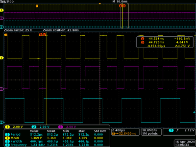

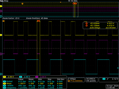

On the next figures, the yellow signal is the High PWM and purple signal the Low PWM. The blue one is just a port that I toggle in the PWM interrupt to show the center aligned mode.
Figure 1  : Duty cycle of 50% OK, but the next pulse is 50% too
Figure 2 : Duty cycle of 25% OK, but the next pulse is 25% too
Figure 3 : unknown PWM duty cycle (35% in principle)
Its look likes there is a reload every 2 cycles, whereas I configure the PWMMC peripheral with a reload every cycle, but is does not explain the unknown duty cycle on figure 3. Moreover, it look likes the bufferisation of PVAL1, PVAL3 and PVAL5 are not applied every cycle.
