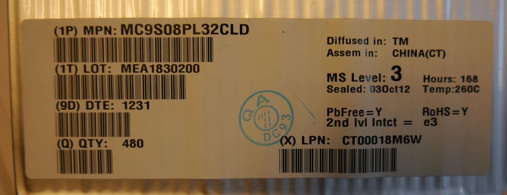

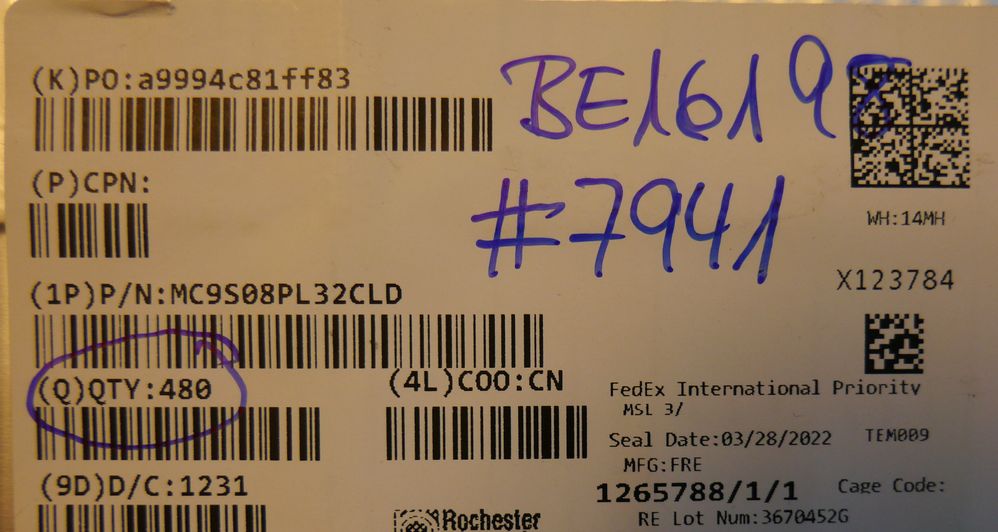

Hard to believe, but true. Could you please look in your records for:
- a MC9S08PL32CLD mask 4N40C errata
- older data sheet revisions that cover our version, date code 1231, lot MEA1830200, still sold by rochester

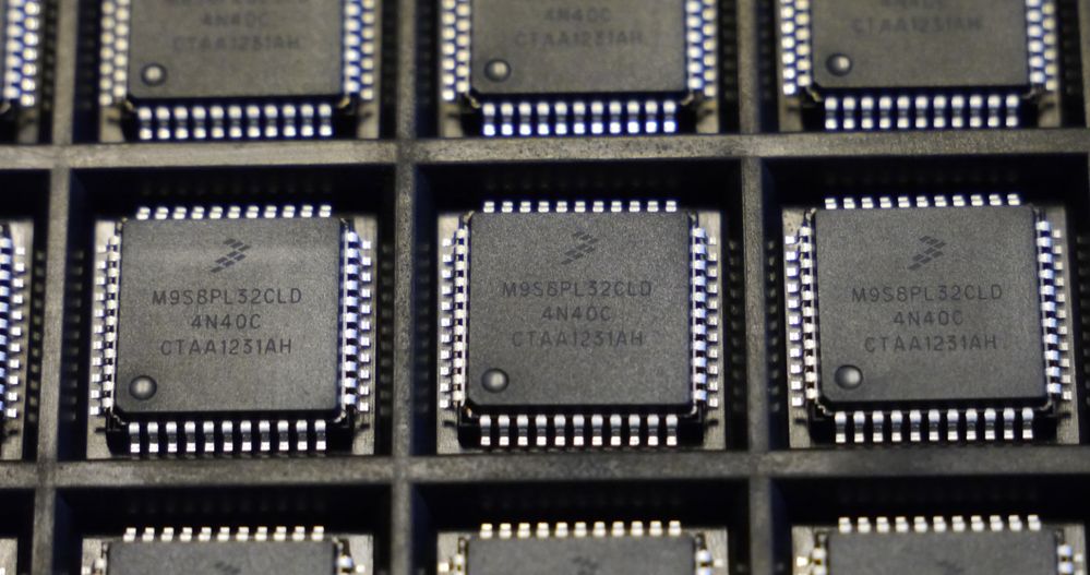

I could not find any information that the PL has the mask set 4N40C maybe is because this is too old, would be possible that you send me a picture of the device
3,115 Views
galahad
They were sold as MC9S08PL32, on the chip you can read M9S08PL32, maybe that makes a difference... Hope that helps!
