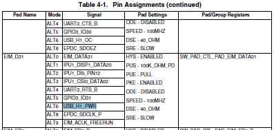

- We are configuring EIM_D31 pad as USB_H1_PWR function.
- EIM_D31 pad is connecting to enable pad of power IC for cutting VBUS supply.
- When iMX6 detect over-current event, I am expecting EIM_D31 output high signal.
I would like to know the control procedure outputting  a high signal from EIM_D31 pad with USB_H1_PWR function.

according to below link nxp bsps use simple gpio for control of that signal
How to control the USB_OTG_PWR and the USB_H1_PWR of i.MX6
In general PP bit in USB_nPORTSC1 register also can be used, details can be
found in sect.65.4.3.2.4 Port Power i.MX 6Solo/6DualLite Applications Processor Reference Manual
