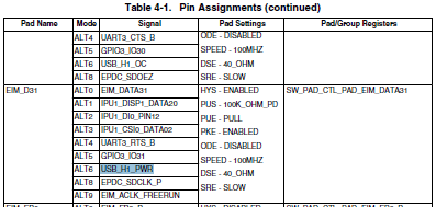

Kazuma_Sasaki
Senior Contributor I
Hi Igor,
Sorry for the confusion.
From RM:
- We are configuring EIM_D31 pad as USB_H1_PWR function.
- EIM_D31 pad is connecting to enable pad of power IC for cutting VBUS supply.
- When iMX6 detect over-current event, I am expecting EIM_D31 output high signal.
I would like to know the control procedure outputting  a high signal from EIM_D31 pad with USB_H1_PWR function.
Kazuma Sasaki.
