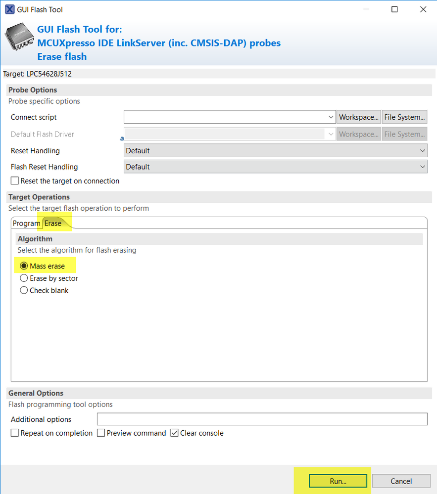

I followed tutorial to get started with LPCXpresso55S69 Development Board | NXP. Everything was running smoothly until the step where I built my own application based on SDK example. Indeed, after a few Build/Debug loops the board suddently stopped working.
Now, when trying to initiate Debug, the probe is properly being detected:
But SWD link to the cores seams not accessible:
Of course I tried to unplugged the board, restart MCUXpresso, even restart my computer but nothing helped. I also re-flash the on-board probe FW using LPCScript tool, but it didn't helped either.
Is there a way to repair the board ?

Hello Jeremy,
How about erase your chip in ISP mode:
Short J10 of board, then press and release RESET button,  open GUI FLASH Tool,
choose "Mass erase" as below, then click Run..:
After completed, remove the jumper on J10, reconnect board with PC, then try to debug again.

jeremygeslin
The "mass erase" did the job, board is working again.
Big Thanks !!!
