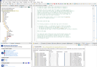

I used LPC54628, designed web server. I found SDK lwip_httpsrv. I can modify HTML file, but which tools can convert HTML to C language arrays? Many thanks!

Many thanks for your reply! What I mean is how to convert HTML files into arrays in C language, not how to parse CGI.
For example, the auth.xml in my picture has been converted to "static const unsigned char httpsrv_fs_webpage_auth_html[]"

xiangjun_rong
This is AE reply:
in SDK's "\middleware\lwip\src\apps\http\makefsdata" folder, there is makefsdata source code for convert HTML to C, customer need use Visual Studio to compile it to exe or other compiler tools for PC OS.
Visual Studio project under folder "middleware\lwip\contrib\ports\win32\msvc"
Hope it can help you
XiangJun Rong
