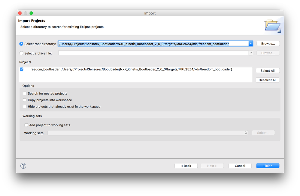

  1. I downloaded the Bootloader 2.0 distribution (NXP_Kinetis_Bootloader_2_0_0.zip) and unpacked it.
  2. In KDS_v3, I clicked on "File => Import"
  3. In the dialog box, I selected "Existing Projects into Workspace" and clicked "Next >"
  4. I chose the "Select Root Directory" radio button and navigated to "ProjectDir/Bootloader/NXP_Kinetis_Bootloader_2_0_0/targets/MKL25Z4/kds/freedom_bootloader"
  5. I unchecked the "Search for nested projects" and unchecked the "Copy projects into workspace" options (see image below)
  6. I clicked "Finish"
Here's what the dialog window looked like before I clicked "Finish":

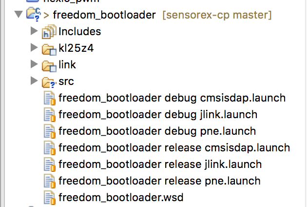

The freedom_bootloader project appeared in my Project Explorer without any warning symbols (that's good):

And I can build the project without error:
06:15:40 Build Finished (took 6s.158ms)

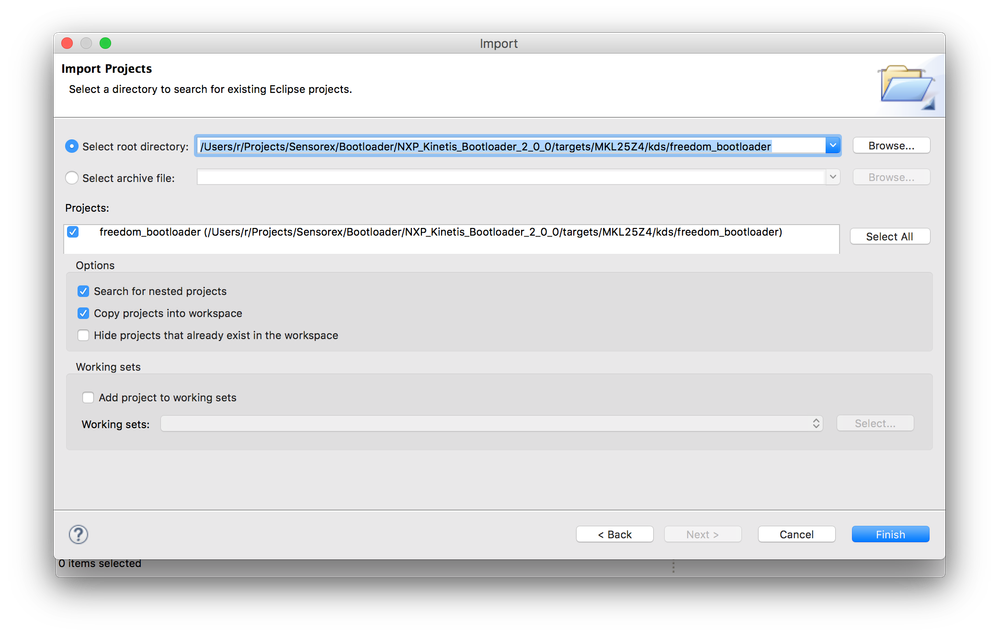

This is similar to attempt #1, but in this attempt, I copied the projects into my workspace.
  5. I checked the "Search for nested projects" and checked the "Copy projects into workspace" options (see image below)

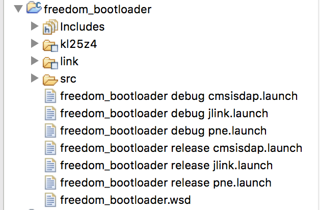

The freedom_bootloader project appeared in my Project Explorer, but it had some warning symbols on the icons:
And when I built the project, I got many errors:
