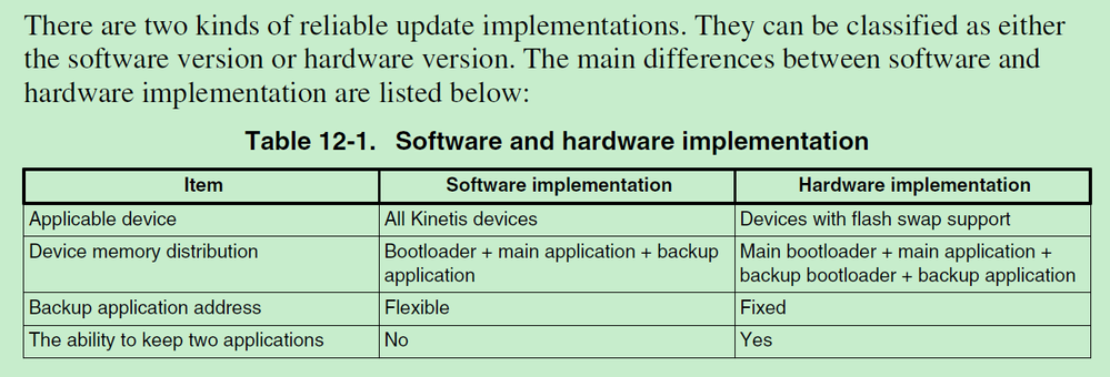

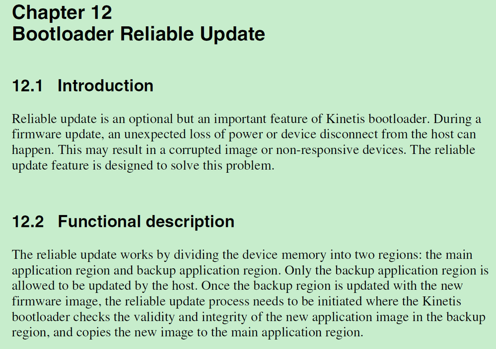

Hui_Ma
Hi Bruno,
So far, the Kinetis bootloader V2.0.0 does support the reliable update.
Please check the KBOOT V2.0.0 reference manual chapter 12 for the detailed info:
The configuration macros defined in bootloader_config.h are used to enable the reliable update feature.
Wish it helps.

brunoalbrecht
Sorry Hui_Ma, but I think you either didn't understand my post or didn't read it entirely.
I understand how the Booloader works and how the Reliable Update works and how it can be configured. My point is: even with the reliable update turned on, it is still possible to overwrite the application area by writing directly to it, which, in my opinion should not be allowed. If you're trying to update your application in reliable way, you shouldn't be able to write over your old application! You should only be able to write on the backup location and then the bootloader would decide whether the application is valid or not to finally, if it is valid, move to the application space.
