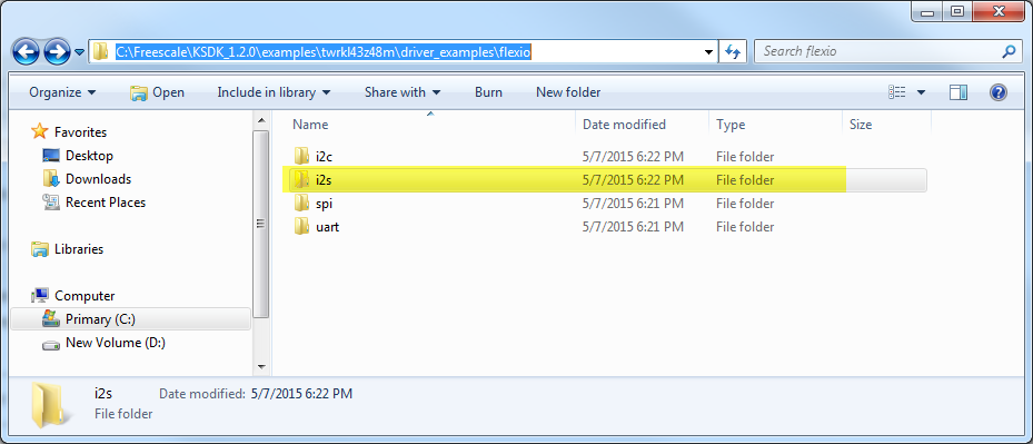

Hello Robert,
I was thinking about you might use the default location when pasting.
When copy&paste project, please don't use the default location, choose the
path where the original project located , on my side , it should be :
after click "Ok" , in the original folder, we can see the project :
Then build the project, there is no error :
Hope it helps
