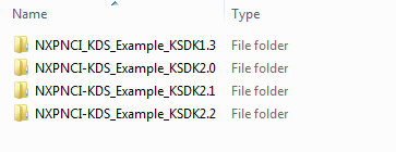

Kan_Li
Hi Chadi SALIBA & Abderrazek MESDOUA,
If you prefer to NFC reader IC, I would recommend PN7120 or PN7150, there is also a FRDM-K64 demo available to work with either of them in P2P mode, you may download it from https://www.nxp.com/webapp/Download?colCode=SW3735&appType=license&Parent_nodeId=1464843492338729907...
The demo is based on the latest ksdk 2.2, so it should be easy to port to FRDM-K82F. Please refer to the following for details.
* Support for all NCI based NXP's NFC Controller (e.g PN7120, PN7150)
 * Support FRDM-K64F NXP's Microcontoller Units
 * Based of KSDK 1.3, KSDK 2.0, 2.1 and 2.2
 * Demonstrates:
    o NFC Forum tags reading (read NDEF message)
    o P2P (NDEF message exchange through NFC Forum SNEP protocol)
    o Type 4 Tag Emulation
    o NFC Forum T2T and T4T tag writing (write NDEF message)
    o Raw tag (non-NDEF) access (MIFARE, ISO14443-4, ISO14443-3A and ISO15693)
    o Multiple tag support (up to 2 of the same technology or multi-protocol card)
Hope that helps,
Kan
