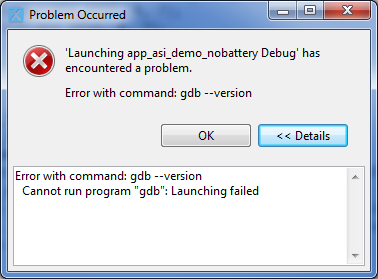

The menu command Run > Debug As Local C/C++ App results in this Problem Occurred msg:
2,784 Views
stevewald
Running LPCXpresso_8.1.4_606 locally on a PC/Windows7.
How do I fix this?

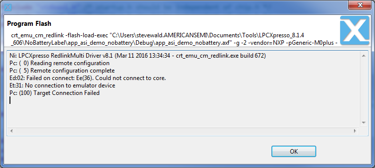

After re-configuring Windows>Prefs>LPCXpresso to use the right MCU and LPC-Link2, and after running Boot Debug Probe, I attempted to reprogram the flash, but got this message:
In my Windows devs & printers panel, the LPC device name changed to "LPC-LINK2 CMSIS-DAP V5.147". Encouraging?
Like I said, I'm a noob with this API & its debug.
