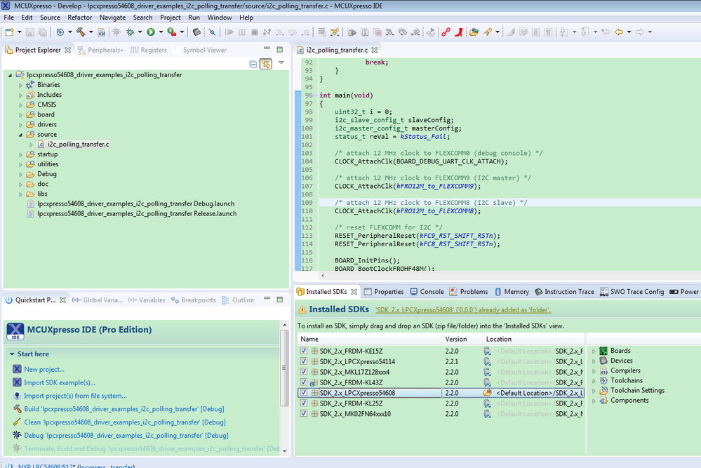

Bought a LPC54608 board,
installed IDE, etc.
compiled an example SDK I2C example project
When i goe to download it i get
"No compatible probes available. They may be disabled, disconnected, not powered, already in use or not compatible with this target."
How do i get the default Link2 probe to show up in discovery ?
I see the LPC-LINK2 CMSIS-DAP V5.173 enumerated under devices in Win7.
The canned DEMO works fine - so i know the board is good.

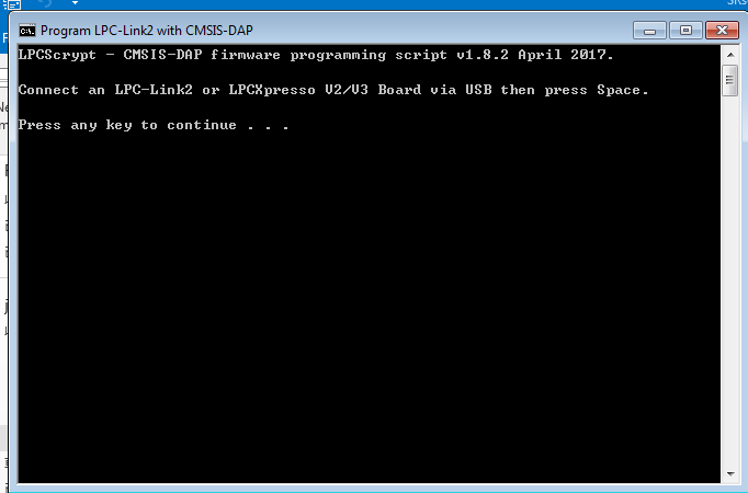

  1) download lpcscrypt tool and install it.
     LPCScrypt v1.8.2|NXP
  2) power down the LPC54608 board
    Short JP5
    Use the USB cable connect J8.

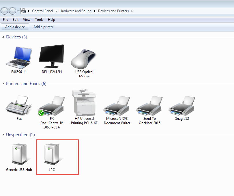

    Open PC: Control Panel\Hardware and Sound\Devices and Printers
   You will find your board is named as LPC, just like this picture:

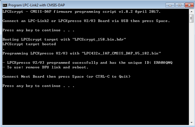

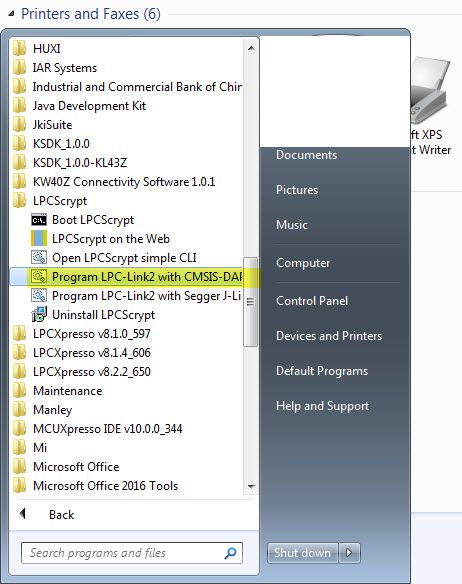

  3)  Open LPCScript, program LPC-LINK2 with CMSIS-DAP window
Press any key, wait the write finished.

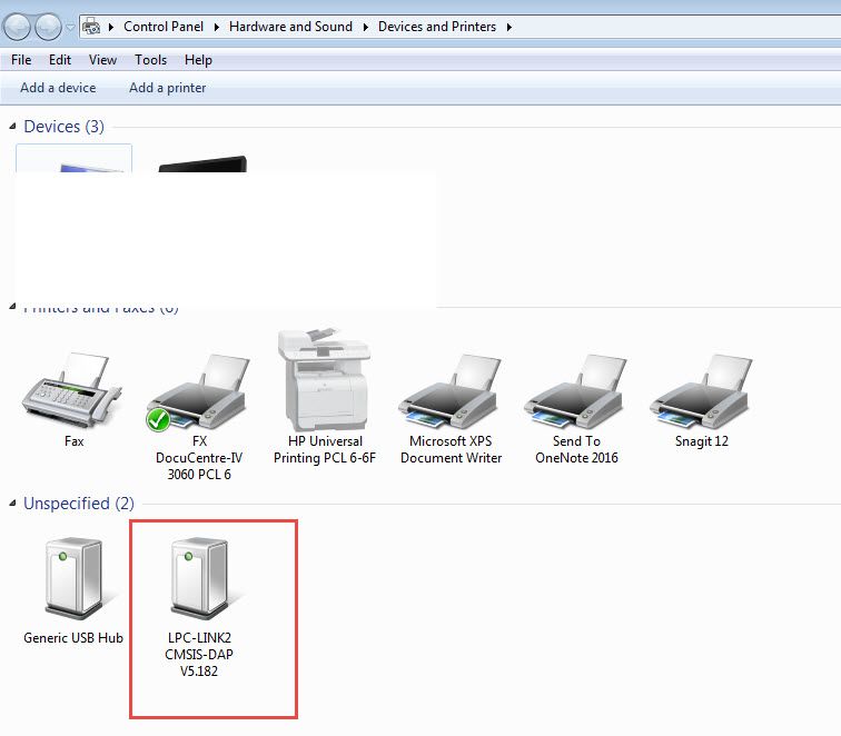

 4) Power off the boad, remove the short between JP5, check PC: Control Panel\Hardware and Sound\Devices and Printers
Until now, your CMSIS DAP is updated as the new version.

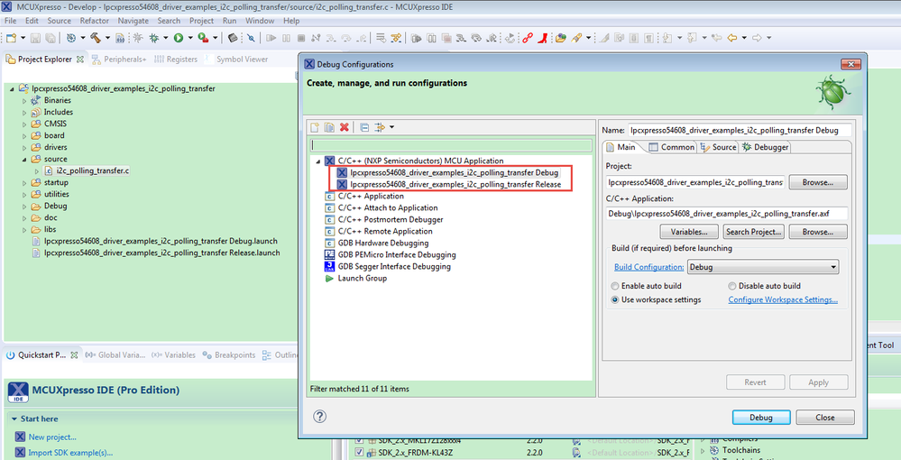

2. Open the SDK I2C example project with MCUXpress
1.) RUN->debug configuration
    Please delete the two files under MCU Application

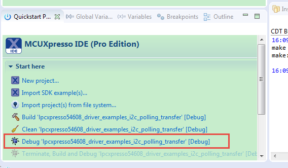

2). Build the project
3). Click debug

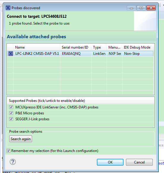

  You will get this window:
Press OK button

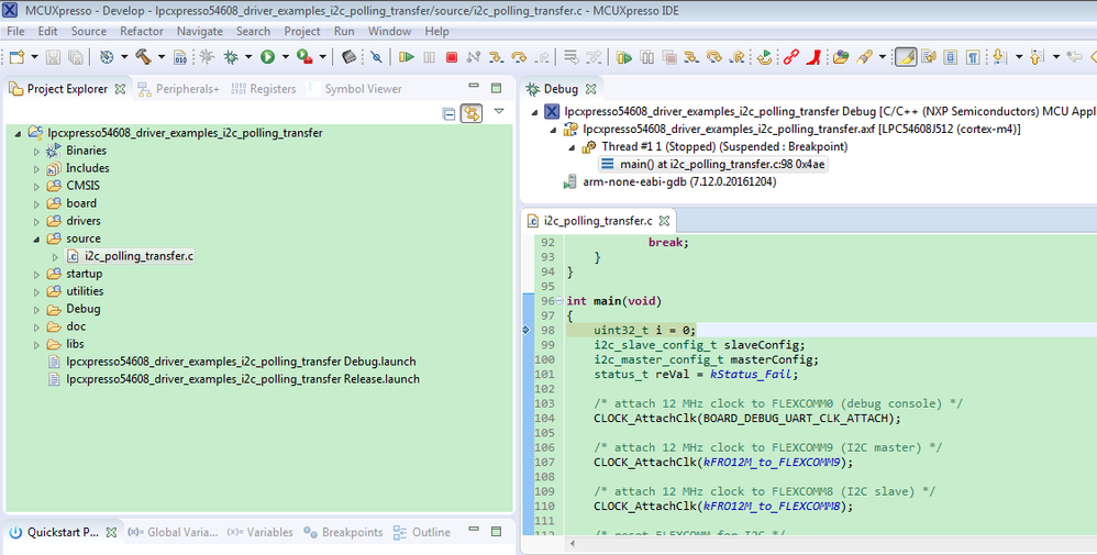

You will enter the debug mode:
Please follow my above steps, and try again.
Any question, just let me know!
