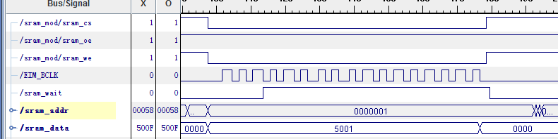

Hello all,
      I use EIM to communicate with FPGA by Synchronous Mode, but have problems。
      I  according 《 i.MX 6Dual/6Quad Applications Processor Reference Manual》page 1046  22.8.9 Burst (Synchronous Mode) Write Memory Access Timing -BCD=1
I configure:read/write sync mode ,SWR=SRD=1, WFL=RFL=0,BL=2,PSZ=2
EIM_CS0GCR1=0X31135387
EIM_CSnGCR2=0
EIM_CSnWCR1= (16 << 24) | //WWSC=16
 EIM_CSnWCR2 =0
EIM_CSnRCR1=(16 << 24) | //RWSC=16
EIM_CSnRCR2=0
EIM_WCR=0
EIM_WIAR not configure
EIM_EAR not configure
in driver write:
   u32 buf_test[100] = {0x5001,0x5002,0x5003......}
   __raw_writew(buf_test, EIM_CS0_baseAddr);
But EIM  bus' data(sram_data) not  increase:
so, how i configure eim , when EIM_WAIT valid, one EIM_BCLK write or read one EIM_DATA?
I have been debugging for a long time. please help me, thank you!!

Hi igorpadykov
    I have the same problem with Navy,the example Sample code to use i.MX6DQ EIM burst access is for IMX53,do you have the sample code for I.MX6DQ?
