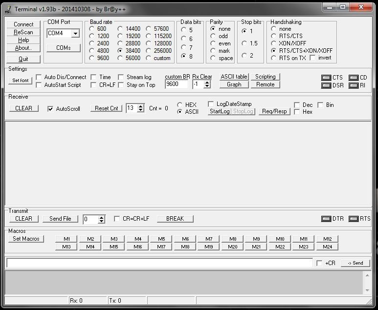

I am using this Terminal Application , which can be found in this link Terminal​Terminal new.jpg
I have written a code for blinking an LED in my custom board. I converted it into .s19 file using
"Create Flash Image option" . I need to send it to the board through through the RS 485 serial connection between the PC and the Board.
CODE 1:
I tried to run this code for sending strings and got the output successfully after toggling PIN 21.

EXPECTED OUTPUT:
MY OUTPUT:
The Code builds and gets debugged into the board without any errors but am not getting any output in the TERMINAL APPLICATION.

Jorge_Gonzalez
Hello Ganesh Ramachandran:
Sorry for the delayed response. Are you still struggling with this?
Just like you mentioned and as commented in your other post, the UART in KE02 devices does not provide hardware flow control signals. But you can still use GPIOs to control UART send/receive.
Since you are using half-duplex RS485, then I assume you have an external RS-485 IC which should have a way to control transfer direction with a GPIO.
In your code above I see you toggle PTA21. If this pin is intended to control transfer direction then the clear API should be placed before the if(CLS1_KeyPressed()) condition, like next:
GPIO_PDD_ClearPortDataOutputMask(GPIOA_BASE_PTR, GPIO_PDD_PIN_21);
if (CLS1_KeyPressed())
Let me know if any doubts.
