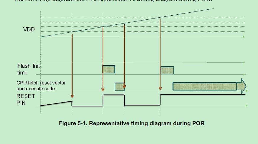

kerryzhou
Hi Tony,
1.  Please use the KSDK2.0 KL27 download your code to your flash again, just make sure it is not caused by your code.
Welcome to Kinetis Expert | Kinetis Expert
Choose FRDM KL27 board.
2. This is is the timing diagram during POR,
  Please use the oscilloscope to check the POR wave, whether it is correct on your side.
  After you check it, then give me your test wave.
Jingjing
