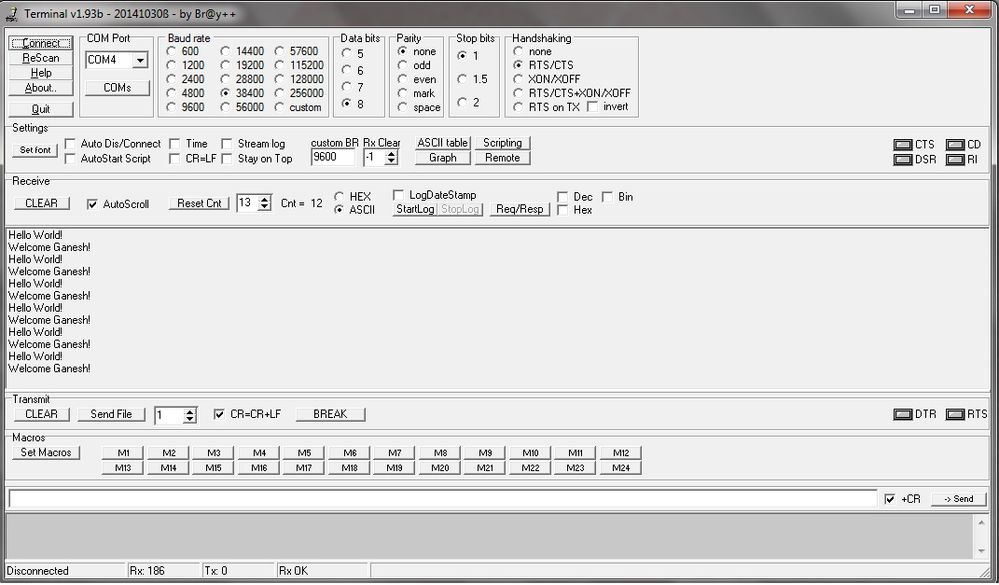

I need to send files/ strings serially to my board. The PTD7 is the UART2 Tx and PTD6 is the UART2 Rx. There is an RS 485 connected to this UART connection. Since RS 485 is Half Duplex, I am facing issues while sending and parsing files, whereas I could send strings successfully.
for(;;) {
   GPIO_PDD_TogglePortDataOutputMask(GPIOA_BASE_PTR, GPIO_PDD_PIN_21);
      CLS1_SendStr("Hello World!\r\n", CLS1_GetStdio()->stdOut);
      WAIT1_Waitms(1000);
      CLS1_SendStr("Welcome Ganesh!\r\n", CLS1_GetStdio()->stdOut);
The output in the Terminal Application which I use is what I desired.
But when I try to execute this code, the terminal application didn't respond. I never got anything on the terminal screen.

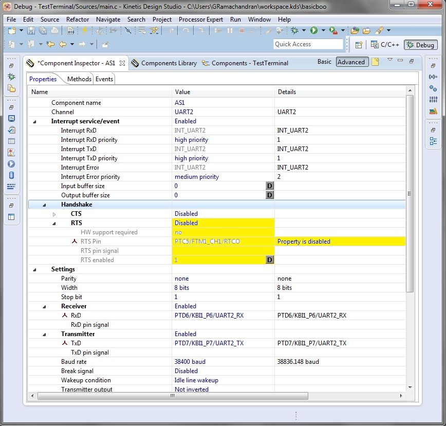

The only possible way is UART should felicitate an automatic handshake (set/reset RTS). When I checked the Processor Expert Component Properties of AsynchroSerial Component I found this. RTS Handshakedoubt.jpg
How does the above feature work ?
Is my understanding of the problem correct ?
How to approach and solve the Issue ?

Hello Ganesh,
From the Reference Manual , the device of MKE02Z64VLD2 does not support RTS and CTS .
And so , please introduce your problem again without RTS clearly , you can first configure the
low baud rate have a try.
Alice

Hello Gnesh,
About this feature , you must enable DMA first, or you  can not use this feature :
Hope it helps
Alice

Where Can I find that DMA in KDS ?
Also I could not locate the RTS PIN in my data sheet yet. I am connecting to UART2 (PTD6 -> Rx , PTD7 -> Tx) . But I couldn't find which is the RTS Pin.

Hello Ganesh,
Alice

Hello Ganesh,
I have check the thread and code you mentioned.
I think first you need set a breakpoint to check whether the UART receive the data PC send .
Then use one flag to send the data that MCU received .
Alice

Hello Genesh,
You can check the UART data register through "EmbSys Registers":
Window ->  show view -> other ....
if you want check variable,  you can use the "Expressions" view:
Hope it helps
