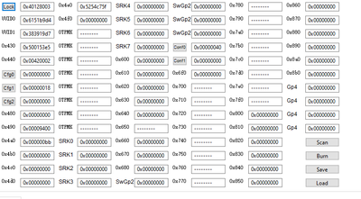

I am having the same issue. All the boards were working fine but now i have 3 boards which i cannot run from flash anymore. I can run the code from RAM and it works but the flash is not working any more. I changed the
flash and still the same issue.
This is my boot configuration and it looks good.

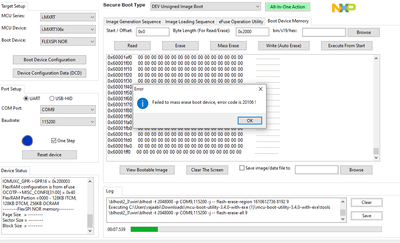

This is the error message i am getting when i do erase or mass erase.

In the board in which mass erase does not works we cannot download the code using serial downloader. The error shows during erase is Failed to mass erase boot device error code is 20106. In other board serial downloader & mass erase is fine working. But in two boards could not connect to core error shows while programming via SWD
