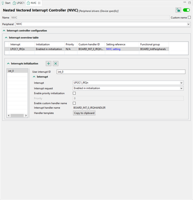

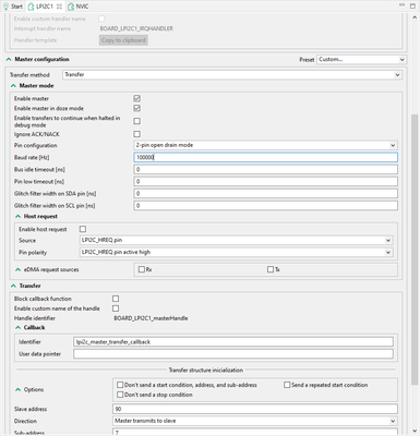

Here is my code, and below it, the initialization config screenshots

Hi all, I have managed to resolve my own problem, if somebody has this issue go to the pin configuration menu and make sure SCL and SDA configured in this way (image below), the configurator tool initializes these parameters in the wrong way, especially the "Software Input On"parameter which is essential and must be ON.
I hope this will help,
