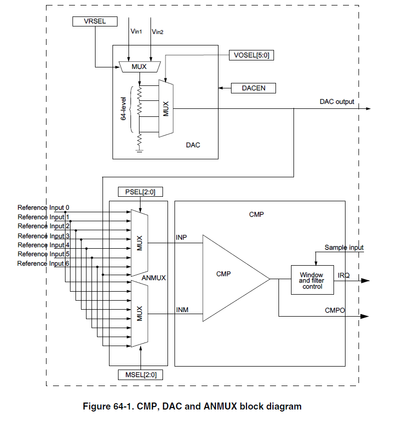

My device is iMXRT1064. I am working on a touch screen which is 4 wire resistive. Its has analog outputs which need to be read. On my prototype board the following pins are used.
GPIO_AD_B0_00      TOUCH_XR_IN         CMP1, IN4
GPIO_AD_B0_01      TOUCH_YD               CMP2, IN4
GPIO_AD_B0_02      TOUCH_XL                CMP3, IN4
GPIO_AD_B0_03      TOUCH_YU_IN          CMP4, IN4
As per iMXRT1064 reference manual these pins are Analog comparator pins.
I only want to read the voltages on these pins. Is it possible to do that? I don't need the comparator.
If yes then please let me know if any reference code is available.

  I checked all your 4 pins:
No one is the ADC pins, these are the CMP pins.
But CMP is used to compare function:
So, if you want to get the detail pin voltage, you need to change the hardware, and connect your touch pin to the ADC interface instead of the CMP interface.
About the ADC pin, you can check the RT1064 RM  Table 9-1. Muxing Options.
I don't think you can use the CMP to realize the ADC function.
Wish it helps you!

anujtanksali
Hello kerryzhou
I just want to confirm, Can we configure these pins through MCU config tool so that these can be used to read pin voltages?
In the above discussions i have mentioned that i have configured these as CMP pins.
Anuj

kerryzhou
Hi Anuj Tanksali
  Unfortunately, these pins are totally not the ADC pins.
  Even it is CMP pins, but it used to compare, not read the detail voltage.
Kerry
