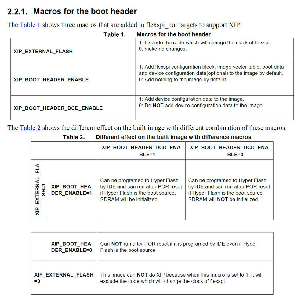

jeremyzhou
Hi Tamir Michael ,
In the attachment, it presents how to set the macros to support the XIP as Fig 1 shows, so please refer to the attachment for details.

tamir_michael
Thanks. I was asking this question because I encountered quite some threads dealing with this issue, and application notes too. So you're saying that tools like "elftosb" patch binaries that do not contain this header to be able to boot from QSPI, and that if those binaries are linked with the header module the usage of "elftosb" is redundant?
