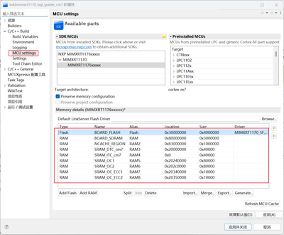

I have meet a wired issue. I use MCUXpresso IDE V25.6 on windows 11 PC with Jlink Plus debug tool and NXP MIMX1176DVMAA as a target(board: MIMXRT1170-EVKB).

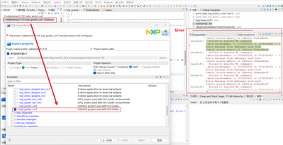

I load a SDK example (lvgl_guider_bm_cm7) to use the Jlink's flash driver. and it works and I could load my code to my target successfully. but I will get an issue as below(as figure 1): Failed to execute MI command: -data-disassemble -s 3735928558 -e 3735928642 -- 3 Error message from debugger back end: Cannot access memory at address 0xdeadbeee, I could not debug my project.

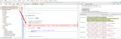

and if I remove the main function lin82 code(as figure 2), I will load/debug my code sucessfully.

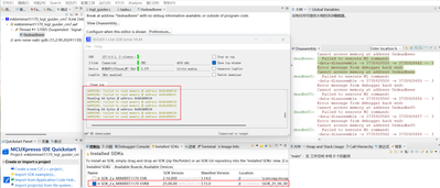

Hi,@Gavin
I am very glad to receive your reply.
I am using the latest SDK package as shown in the image below.
In addition, I would like to ask, is there a problem with my JLINK tool?

Hi @zhuangfei ,
I'm not sure if this is a problem with your debugger. The RT1170-EVKB has an on-board MCU-Link, you can change its firmware to Jlink and try again using this on-board JLink debugger.
