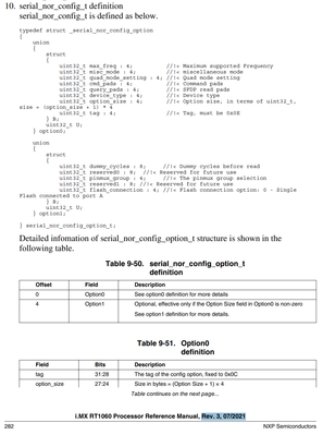

This is just to let you know I believe there's an error in the reference manual for i.MX RT1060 Rev. 3, 07/2021, specifically the value of
serial_nor_config_t.option0.B.tag
In the code snippet on p.282 it says the value must be 0x0E, whereas in Table 9-51 on p.282 it says that the value must be 0x0C (see image).
From experience I believe 0x0C is correct for the i.MX RT1060.
タグ(2)
1 返信
188件の閲覧回数
Omar_Anguiano
Thank you for letting me know about this typo in the documentation. 0x0C is the correct value.
Let me report it to the corresponding team so it can be fixed in future releases.
