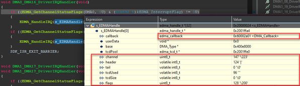

Habib_MS
Hello @pooisonner,
It appears the problem stems from the way g_edmaHandle is currently being instantiated. Right now, you're creating g_edmaHandle inside the dmaInit function. This means that the memory allocated and configured for g_edmaHandle is local to that function and gets discarded once dmaInit completes execution. As a result, any values set within g_edmaHandle are lost.
This behavior is evident in the first two transfers:
First transfer (Works correctly):
Second transfer (Fails due to missing or incorrect parameters):
To resolve this, please declare g_edmaHandle as a global variable. This will ensure that its configuration persists beyond the scope of dmaInit, maintaining the integrity of the EDMA handle across multiple transfers.

Habib_MS
Hello @pooisonner,
