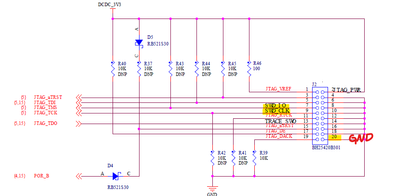

6,407件の閲覧回数
kerryzhou
Hi @MCW ,
   Thanks for your information.
  To the JTAG pin, pin 1 3.3V is must, otherwise, your JTAG/SWD can't work, you can check this log:
The VTref is used for the JTAG to detect the voltage.
Wish it helps you!
Kerry
