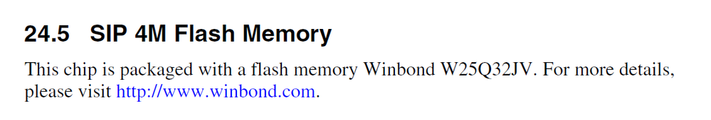

Getting the flashloader working on the MIMXRT1064-EVK will be an amazing hurdle to get over.  This flashloader was ported over from that of a different MIMX family member, the 1050.  I know that the 1064 has 4MB of Quad-SPI Flash.  This shows up as external memory in section 2.1 of "i.MX RT1064 Crossover Processors Data Sheet for Consumer Products, Rev. 0.1 01/2019" and appears on the block diagram as "Dual Channel QuadSPI" "Hyper Flash."  On the same block diagram, we show an Internal memory of 4 MB Flash.  Can anyone explain if this flash exists as shown on the diagram, and/or if it actually somehow the same flash as the QuadSPI external memory.
My belief that all of the flash on MIMXRT1064 resides in external memory space.  Please correct me if I am wrong.

FelipeGarcia
Hi Paul,
The i.MX RT1064 has a W25Q32JV flash memory mounted on chip. The behavior as an i.MX RT1060 connected to an external W25Q32JV via pins. This saves you space and connections to an external memory.
