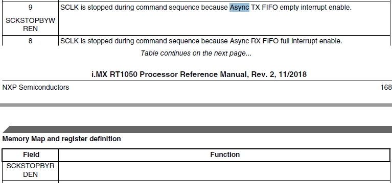

I have problem with page program NOR flash memory using FLEX SPI with AHB.
I want store data using direct write to mapped address:
for(int i = 0; i < 0x100; i++)
   *(uint8_t *)(FlexSPI_AMBA_BASE + i) = i;
However, Chip Select interrupts programming sequence.
the manual says that: "For Flash reading/programming triggered by AHB command: Internal async FIFO for flash reading/programming should never be full/empty."
How to check TX FIFO status correctly ?
Kamil
1,468 Views
jeremyzhou
Hi Kamil ,
1) How to check TX FIFO status correctly?
-- Actually, only two interrupts can indicate the status of the async FIFO.
I was wondering if you can introduce hardware design about the external QSPI,
it close relates to AHB read and write operation.
TIC
