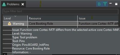

I have another question for the same setup: I am trying to make the M4 control Ethernet communication via the KSZ8081.
To do this, I've tried to copy the pinmux setup in the evkmimxrt1170_enet_txrx_transfer_cm4 example (a cm4 standalone project) in my M4SLAVE project, but the pinmux file won't generate when I click on 'Update Code' (see screenshot below).
I have also included a screenshot of the warning I get under "problems", below.
Could someone please tell me how I can fix this?
Kind regards

victorjimenez
Regarding the problems when creating a multicore project from scratch, this is a problem with the SDK. The corresponding team is already checking this, so it will be fixed in future releases. In the meanwhile, instead of creating a multicore project from scratch, you will need to use as a base one of the SDK example projects and add the drivers that you want.
Regarding the question about the Ethernet. Since this is not related to the original question, I have to ask you to create a new community thread. I apologize for the inconvenience that this might cause you.
Victor
