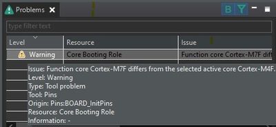

However, with this setup, I cannot use ConfigTools to generate the pinmux.c code. 

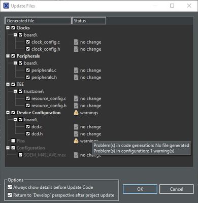

I can use ConfigTools as per usual, until I click on 'Update Code'.
At this point, I get a warning:
When I press 'OK', the code in pinmux.c is not changed (as one would guess from the fact that it is greyed out). I cannot tick the box next to 'Pins'.
I assume it is related to the warning that I get in the ConfigTools view:
I can do the Pinmux as per usual in the M7 Master project, but I need to configure some pins in the M4 Slave project.

I've replicated the phenomenon and I think the mcuxpresso config tools doesn't support the feature now, in further, I'll report the finding in the next round of field trial.

1) Could you please provide me with a suitable workaround while we wait for this feature to be supported?
-- Actually, it needs the developers to add or modify the code manually.
