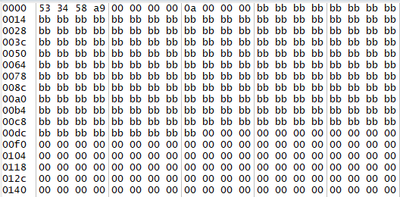

Binary file when my_variable = 21300
But, when my_variable has value that follows this pattern (in little-endian):
0x53any number from range [0x30, 0x39]any number from range [0x00, 0xFE]any number from range [0x00, 0xFE]
script fails with error "error: invalid hex digit".
Example:
As you can see, the only thing that changes is the first 4 bytes. Also, what's important is that, first 8 bytes have to be followed by
0A 00 00 00
for the script to fail.

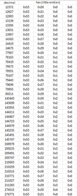

My guess is that this particular byte configuration is read in some mysterious way, but I couldn't find any information about this. Here is a glimpse of some of the bytes that caused script to fail:

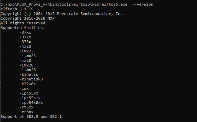

The MCUXpresso Secure Provisioning tool  (SPT for short )v7.0 implements elftosb to generated signed  (HAB) images, v8 now implements nxpimage instead. The SPT v7.0 runs  elftosb 5.1.19. You could download our SPTv7.0 and take the elftosb.exe from there and test.
I saw that you are using kinetis command , rather than  i.MX command when generating your SB file. Another thing is that I do not recognize your input binaries as raw i.MX RT application images, apparently,  you are working on a custom file, not a raw i.MX RT application image. This could limit our support ability for this scenario. Could you clarify? The SPT v7 or V8, should support you to generate signed images for High Assurance Boot (HAB)

Unfortunately, elftosb In version 5.1.19 fails too.
I am working on custom file. First 32 bits are my specific number, which works in most of the cases. The only pattern i noticed is that when binary file starts with 0x53, <0x30, 0x39> it always fails.
In ASCII it looks like these two signs cause the problem:
"S0", "S1", ... "S9"

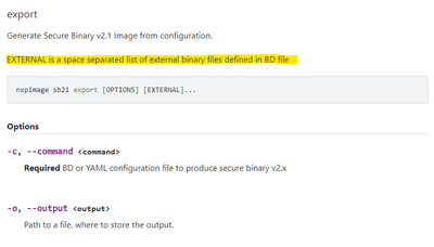

according to the documentation:
I should be able to use binary files. My .bd configuration file starts with:
thus, everything should work fine. But I come with an issue:
Could you tell me what the error means?

I have not used this command before;  I presume that you may have been missing keys? Did you had success using the LPC55s69 example?
There is another tool that you might use. it is the image tool from the open source MCU bootloader project. I think this tool might also be a choice for you since, it is not specifically dedicated for NXP MCUs. We use the image tool for a project called SBL, please check to this command in the MCUOTASBLSFWUG
