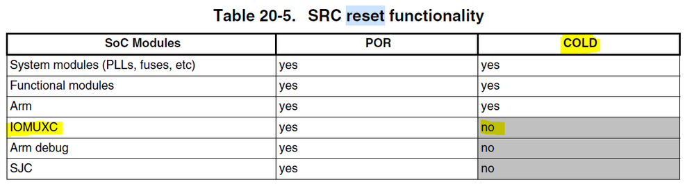

This tells me (and I believe I managed to see it once with the debugger connected before it lost connection) that these types of reset don't reset the IOMUXC. This is also confirmed in the user's manual:
My explanation is that, since I disable OCRAM and the ROM loader uses it for its stack the ROM loader can no longer operate (without RAM) if I don't set it back.
This is OK for the reset case since one can control the FlexRAM layout (as above) to ensure that it always works reliably. But the watchdog case is not guaranteed - one needs to install a watchdog interrupt handler to prepare for the subsequent reset (which takes place 255 clocks later). This is however not fool-proof due to the fact that in the case of a serious firmware runaway error also this interrupt may fail (or its vector in RAM be lost).
Also in a system where the FlexRAM is left in its default state there is no guarantee that runaway code can't write to IOMUXC_GPR_GPR16 and change the configuration (this can't be locked/protected against), meaning that in high reliability systems I think that one is forced to use an external HW watchdog to recover via a power on reset (which can't subsequently be detected in the reset controller....).
It would be better if this register were really set to its default value on a COLD reset so that the ROM loader is not killed. or if the ROM loader itself would write IOMUXC_GPR_GPR16 = (IOMUXC_GPR_GPR16_RESERVED | IOMUXC_GPR_GPR16_INIT_ITCM_EN | IOMUXC_GPR_GPR16_INIT_DTCM_EN);
as its first line of code to ensure that it can actually operate in every situation.
