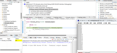

Thanks you questions, we are checking this issue and trying to find the root cause. Let me update the status as below.
1. We cannot reproduce the problem on a local setup. The IDE seems really decent even with 40+ ThreadX threads (ThreadX example). Is it possible to provide ELF image which can be run on reference RT1060 EVK/EVKB board, we want to reproduct this issue based on yours.
2. J-Link is another probe with Azure RTOS GDB thread awareness support  (check the User Guide), J-Link thread awareness might be faster.

I've attached an ELF that's a modified version of the threadx_demo sample in the SDK for the 1060EVK. Here's how threadx_demo.c looks:

We tried the same code with over 15 threads, but problem not reproducible.
We use RT1060 EVKB with CMSIS-DAP/J-Link(on board, LPCXpresso55S69, default) and 1170-EVK + J-Link(onboard, LPCXpresso55S69).
https://community.nxp.com/t5/i-MX-RT-Knowledge-Base/Using-J-Link-with-MIMXRT1060-EVKB-or-MIMXRT1040-...
B.R,Sam

Note: Over 14 thread working well as below.
