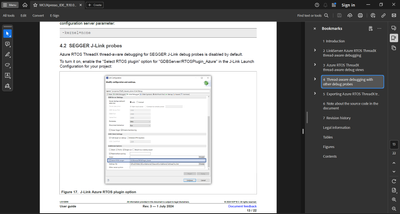

Sam_Gao
Hi @dafela
Thanks you questions, we are checking this issue and trying to find the root cause. Let me update the status as below.
1. We cannot reproduce the problem on a local setup. The IDE seems really decent even with 40+ ThreadX threads (ThreadX example). Is it possible to provide ELF image which can be run on reference RT1060 EVK/EVKB board, we want to reproduct this issue based on yours.
2. J-Link is another probe with Azure RTOS GDB thread awareness support  (check the User Guide), J-Link thread awareness might be faster.
B.R,
Sam

Got it, I am looking for some tools guys to check the arguments from IDE, please wait for a moment.
BTW, It works well for both 'RT1060 EVKB with CMSIS-DAP(MCU-Link)' and 'RT1170 EVK with J-link', please see below shown. Please note: ALL-Stop(default is non-stop) means RTOS thread awareness is enabled. Actually for any rtos.
Note
All-stop and non-stop refer to something else actually... But that's the effect of using all- vs. non-stop with LinkServer.
Non-Stop Mode (Debugging with GDB) (sourceware.org)
All-Stop Mode (Debugging with GDB) (sourceware.org)
As described in the User Guide, you'll see only the executing thread in Debug view, when RTOS GDB thread awareness is disabled. You'll also see in the User Guide that J-Link needs an extra activation step for RTOS GDB Thread Awareness - see "4.2 SEGGER J-Link probes"
Would you please try NXP IDE-MCUXpreeso to reproduce it?
