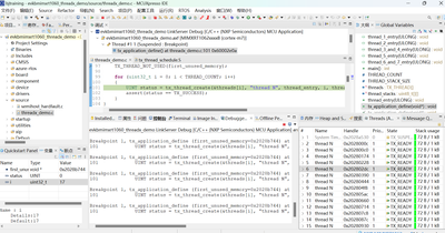

1. We cannot reproduce the problem on a local setup. The IDE seems really decent even with 40+ ThreadX threads (ThreadX example). Is it possible to provide ELF image which can be run on reference RT1060 EVK/EVKB board, we want to reproduct this issue based on yours.
2. J-Link is another probe with Azure RTOS GDB thread awareness support  (check the User Guide), J-Link thread awareness might be faster.

We tried the same code with over 15 threads, but problem not reproducible.
We use RT1060 EVKB with CMSIS-DAP/J-Link(on board, LPCXpresso55S69, default) and 1170-EVK + J-Link(onboard, LPCXpresso55S69).
https://community.nxp.com/t5/i-MX-RT-Knowledge-Base/Using-J-Link-with-MIMXRT1060-EVKB-or-MIMXRT1040-...
B.R,Sam
5,478件の閲覧回数
MulattoKid
Hi @Sam_Gao,
Right, we haven't tried on an EVK, only our custom PCB + MCULink. We do have a standalone JLink Pro, so I hope to test that sometime next week with our setup. I'll report back here.
5,459件の閲覧回数
Sam_Gao
Thanks, please let me know if this issue can be reproduced.
Note: Over 14 thread working well as below.
