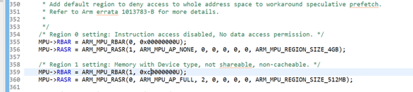

liuhailong_0-1698886319161.pngliuhailong_0-1698886319161.pngliuhailong_1-1698886398657.pngliuhailong_1-1698886398657.png
SRAM can only use 0XC0000000, and is the SEMC region, I want to ask, the SEMC3 address in the figure is 0xC0000000, why I write the code, in CM7 can not achieve the results, and CM4 can, can refer to my latest attachments

jingpan
Hi @liuhailong ,
Please modify two place.
And in board.c
Jing

liuhailong
hello,thanksThe first picture shows the configuration of sdram. Please ask if there is a configuration of sdram. The second picture is region 1, but I need to use region 3, SRAM's exclusive region.
9,551 Views
jingpan
1. It's just a name. You can rename it to SRAM or any thing else. Please focus on address.
2. SEMC0~SEMCn belong to SEMC address range.
Jing

liuhailong
Ok my problem solved,can you tell me the reasons that cm4 program does not need to be set,But CM7 has to board.c  and settings like that you give me the two pictures?
9,430 Views
jingpan
Hi @liuhailong ,
Their MPU and control code is different.
Jing
