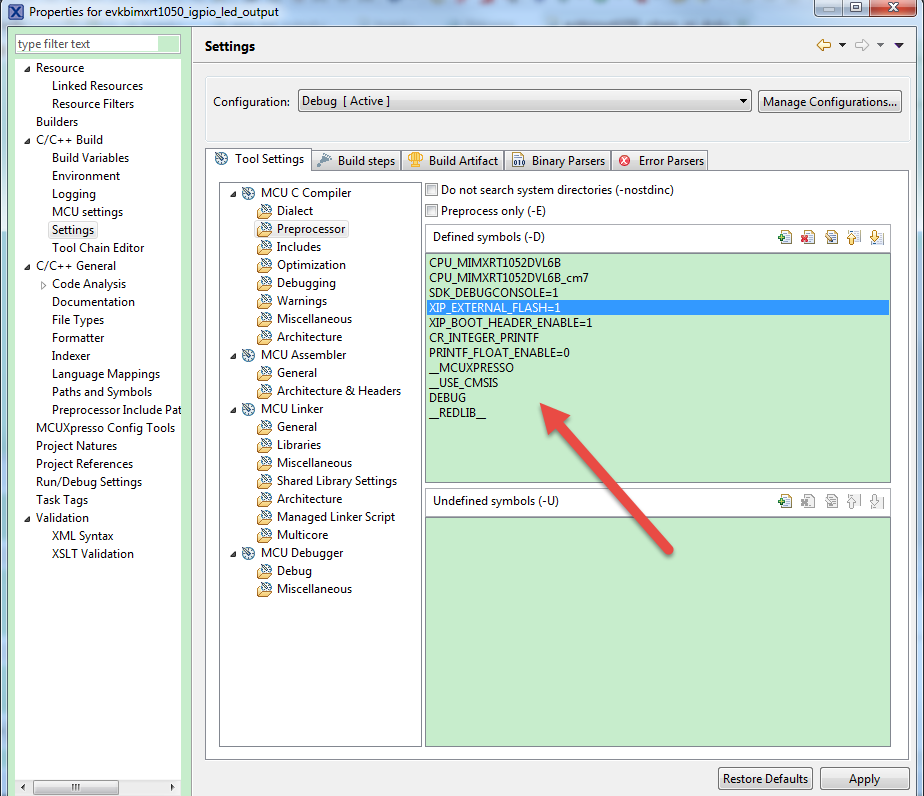

jeremyzhou
Hi Massimiliano Francone,
Thanks for your reply.
After checking, the igpio_led_output demo's IVT doesn't contain the DCD which is configuration information contained in the program image (external to the ROM) that the ROM interprets to configure various peripherals on the chip, likes the SDRAM, in another word, the SDRAM is not initialized, so it will be unavailable.
So you should add macro
XIP_BOOT_HEADER_DCD_ENABLE =1 in the Defined symbol (Fig 1) to enable the SDRAM.
Fig 1
TIC
14,258 Views
massimiliano_fr
Hi jeremyzhou‌,
I forgot to tell you that I've already defined such symbol in the preprocessor tab, thus my SDRAM is initialized. At the beginning I didn't set it, but after some search on the web, I realized the necessity of such symbol.
Thus, my SDRAM is initialized correctly and I manage to read it, indeed. The problem is that the debug session gets blocked if I try to read it again after many step. Did you manage to read from SDRAM without issues?

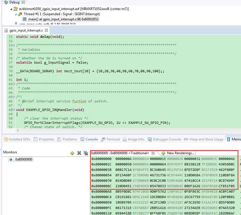

jeremyzhou
It seems a bit weird, as I don't encounter a similar error you mentioned above when I did the testing on my site (Fig 1), I just added the below two macros in the Defined symbols window of the demo.
XIP_BOOT_HEADER_DCD_ENABLE=1
SKIP_SYSCLK_INIT
Fig 1
