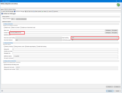

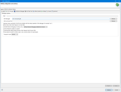

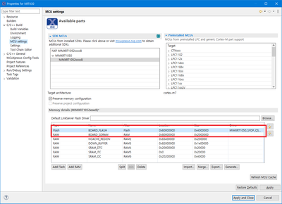

I'm using RT1050 mcu, MCUXpresso 11.5, sdk 2.11.1 and FreeRTOS
I'm trying to use this device in various cases, I've successfully compiled and debugged a project running in flash.
Now I'm trying to do the same thing in external SDRAM, but with no success.
I've modified the project settings:
abs_setian_1-1709710388080.pngabs_setian_1-1709710388080.pngabs_setian_2-1709710413550.pngabs_setian_2-1709710413550.png
abs_setian_3-1709710501110.pngabs_setian_3-1709710501110.pngabs_setian_4-1709710514691.pngabs_setian_4-1709710514691.png

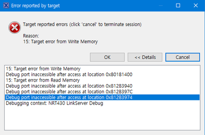

From the console debug messages it seems that the program can't access memory.

request to clear DAP error failed - status 5
After error Nn(05). Wire ACK Fault in DAP access -
Failed to read address register in DAP - Nn(05). Wire ACK Fault in DAP access
Target error from Write Memory: Em(17). Debug port inaccessible after access at location 0x80181400
Target error from Read Memory: Em(17). Debug port inaccessible after access at location 0x812B3940
Target error from Read Memory: Em(17). Debug port inaccessible after access at location 0x812B397C
Target error from Read Memory: Em(17). Debug port inaccessible after access at location 0x812B3974
GDB stub (C:\nxp\MCUXpressoIDE_11.5.0_7232\ide\plugins\com.nxp.mcuxpresso.tools.bin.win32_11.5.0.202112161150\binaries\crt_emu_cm_redlink) terminating - GDB protocol problem: Pipe has been closed by GDB.
error closing down debug session - Nn(05). Wire ACK Fault in DAP access
What am I missing to debug a program in SDRAM?

Hi @abs_setian,
Please follow the following knowledge base article to execute a mass erase and recover debug connection with the core: RT board recovery for debugger connect issues - NXP Community
Then, you can follow this other post to generate an image executable by RAM: Generating a Bootable Image for the RT1050 - NXP Community
Let me know if it helps!

Hi @abs_setian,
Thanks for the clarification. In that case, you can follow these other two community posts. This first one is for the RT1170, but it describes the steps necesary to achieve RAM debugging:
Solved: RT1170 debugging when application is built for SDRAM - NXP Community
Next, attached to this post is a sample project for the RT1064, which can be useful for your RT1050 as well:
Solved: Can't debug code link to RAM with Jlink - NXP Community
