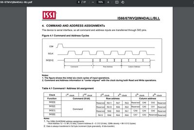

I also don't see exactly what I expect for the command/address lines.  I'm attempting to interface to an ISSI IS66WVQ8M4DALL/BLL device.   I made some adjustments to the LUT entry to accommodate the SDR for command and DDR for the address and data (as required by the device).   The command seems to come out as expected, but the address does not.  (This device has a "strange" requirement on the position of the row and column bits that requires some adjustment of the source address delivered to FLEXSPI.)   Note that reading the ID register doesn't really need a complicated address, but I'm using this command to view the behavior of FlexSPI.

One other place I'm having trouble is defining row and column bits for the PSRAM I'm using.   I think I understand the RADDR_SDR/DDR and CADDR_SDR/DDR LUT commands as sending row and column address bits, but seem to be having trouble getting CAS bits to come out.   The operands for these LUT commands indicate how many bits should be sent.   There is also a parameter named columnspace that appears to define how many bits are in the column address.
My PSRAM (ISSI ISS66WVQ8M4DALL/BLL) has a "strange" CAS configuration.  The CAS portion is 9 bits, but offset/embedded with some reserved ('0') bits to fill in a full 16-bit CAS field:
For IP style accesses, I can manipulate the address, so I take the original access address and break it into a row section and column section (with the column bits properly adjusted).   The row part is placed in bits 31:16 of the new access address and the column portion is placed in bits 15:0 of the new access address.   Then the access is started with RADDR_DDR with 16 bits and CADDR_DDR with 16 bits.   Columnspace is set to 16.   My assumption is that the row bits are taken from the address register (offset by the columnspace bits) and the col bits are taken from the address register starting at bit 0.   But I don't see any column bits (they are all '0').     I got around this by treating all of the bits as row bits and using RADDR_DDR with 32 bits.
But this won't work when trying to access via AHB.   The AHB address to FlexSPI translation appears to go directly to the LUT, so there isn't an opportunity to modify the bits to deal with the CAS offset as needed by this device.    I may need to design in a different PSRAM...

Thanks again for your reply.   Yes, I set the CAS value, but I believe this defines the number of bits for the column portion of the address.   But I need to offset those bits by 5 (the low order 5 bits of the column address field (to the PSRAM) are reserved), then put in the 9 actual column bits, then pad the remainder of the column bits.    I submitted a new question to NXP...
