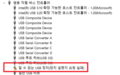

I tested evkbmimxrt1170_dev_hid_generic_bm_cm7 example with MiMXRT1170-EVKB.
It is work well.
I want to use flexspi nor flash and dev hid usb in the same project.
I added the linkscript from evkbmimxrt1170_flexspi_nor_polling_transfer_cm7 to evkbmimxrt1170_dev_hid_generic_bm_cm7.
But the EVK was not detected.
If linkscript is not added to the project, the USB is recognized, but flash related functions do not work.
How can I solve this?
Please see attatched source zip file.
Best Regards
542 Views
EdwinHz
Hi @dskim2,
Due to the complexity and dependencies of the FlexSPI example code, I would recommend you port the USB capabilities to the FlexSPI example, rather than the FlexSPI capabilities to the USB example. On the evkbmimxrt1170_flexspi_nor_polling_transfer_cm7, add the USB component using the "Manage SDK components" window, and then copy and paste the code from evkbmimxrt1170_dev_hid_generic_bm_cm7 that you wish to incorporate into the project.
BR,
Edwin.
