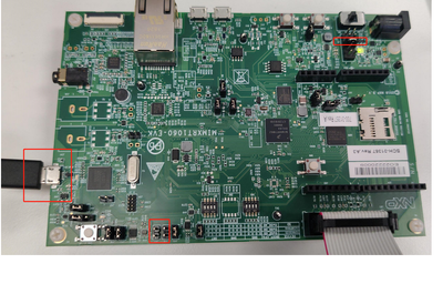

When using the development board, we disconnect jumpers J47 and J48 per the user manual for JTAG operation. This is a brand new out-of-the-box development board with jumper J1 set to 3-4 for input power on J9. Connection fails in the same manner as our custom hardware. Please see below for connection failure output.

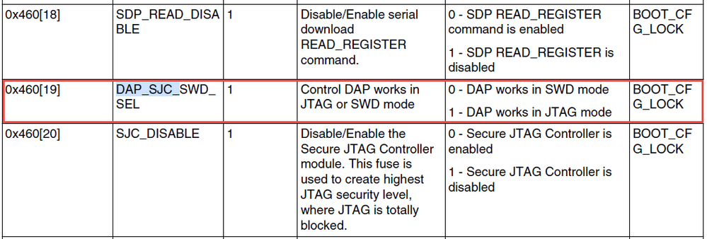

The JTAG debug mode is disabled default, you need to assert the DAP_SJC_SWD_SEL bit to enable the feature.
Note that, the JTAG_MOD should be pull-down by use 4.7 kΩ or tie to GND, other pins don't need to add a pull-up or pull-down resistor.

   I also meet this issue when I use Segger JTAG Prob to connect the target MIMXRT1062DVL6A on MIMXRT1060_EVK. The configuration same as above. And I also have configured the "eFuse Operation Utility" , and all the connection and power supply same as you suggestion but unfortunatelly the JTAG connection still failed! could you please help me to solve this issue, thanks in advance!

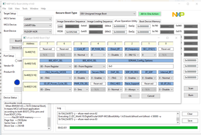

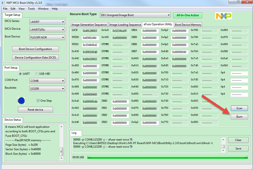

It's not necessary to run a demo to write the DAP_SJC_SWD_SEL bit actually, I'd like to suggest utilizing the NXP-MCUBootUtility tool which provides graphical UI for the developer to burn the eFuse area (Fig 1), and you can learn more information about the tool via below link.

mike-dekoker
Hello Jeremy,
This is good news, thank you. Our hardware includes the USB interface so we should be able to go that route. Thank you for your time and help, it is greatly appreciated.
