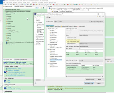

example code executed without any errors,
i solved above the issue by
project properties ==> settings ==> manager linker script => link application to RAM ==> Apply and close.

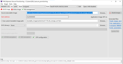

1. Can you suggest me any tool to dump .hex or bin file to rt1170.
=>Answer: If your app is the flash app, then you can use the debugger download it directly.
If your project is the RAM project, then it is the non-xip demo, you need to do the 0X2000 offset, then generate the .hex, and use the MCUBootutility or the SEC tool to download it.
You can refer to my document:
https://community.nxp.com/t5/i-MX-RT-Knowledge-Base/How-to-load-MDK-RAM-app-to-the-RT1170-external-f...
2. I have noticed application running from RAM. but it should run from flash what are the things i need to change to run from flash
=》Answer:
Deselect the link to RAM:
Kerry

Issue is not in my side, just we have to do the following configuration after importing the example.
