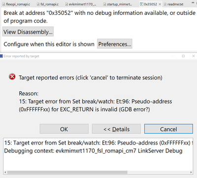

Dear i am developing custom bootloader for our application.
To store the received bin file new memory location of flash memory. i started exploring the flexspi rom api, when i execute this example without changing anything in the example code, my code getting crash.
IMxrt1170
void ROM_API_Init(void)
if ((ANADIG_MISC->MISC_DIFPROG & ANADIG_MISC_MISC_DIFPROG_CHIPID(0x10U)) != 0U)
g_bootloaderTree = ((bootloader_api_entry_t *)*(uint32_t *)0x0021001cU);
else
g_bootloaderTree = ((bootloader_api_entry_t *)*(uint32_t *)0x0020001cU);
after this function
status = ROM_FLEXSPI_NorFlash_GetConfig(FlexSpiInstance, &norConfig, &option);
during above function call program getting crash.
For execute example code is it required to change anything? with respect rt117xx

kerryzhou
Hi @sandeepc ,
   Thank you for your interest in the NXP MIMXRT product, I would like to provide service for you.
   Yes, I also find this issues, and will also do more digger in about it.
    I also find, if you do the flash mass erase at first, then you can pass the rom_api testing.
    BTW, if you test this code, no matter flash have code or not, all works OK:
\SDK_2_15_000_MIMXRT1170-EVK\boards\evkmimxrt1170\driver_examples\flexspi\nor\polling_transfer
  So, when you test it, you can try:
1. rom_api: do mass erase at first before flash testing.
2. run flexspi_nor_polling_transfer demo
About the mentioned issue, I will do more testing on my side, any updated information, I will let you know.

sandeepc
example code executed without any errors,
i solved above the issue by
project properties ==> settings ==> manager linker script => link application to RAM ==> Apply and close.
But i am trying to write 40 kb which is starting address of 0x300
few pages are writing and few pages are not writing sometimes i added delay between the every rom write and erase function.
What might be the reason?
