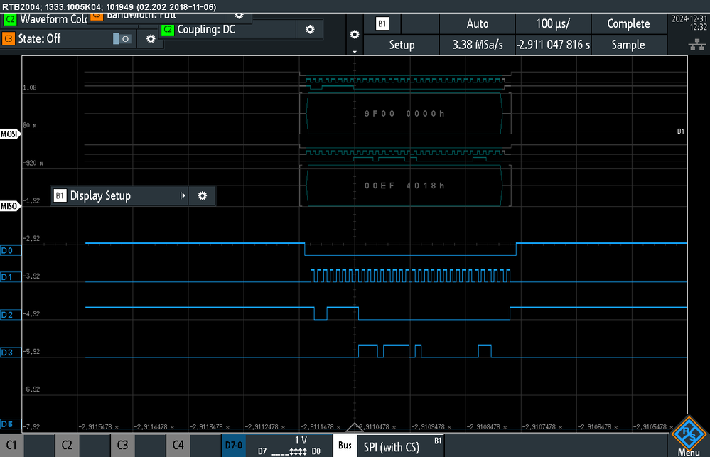

1) Function ReadFlash. Framesize set to 32 bits. JEDEC ID command 0x9F and three dummy bytes all sent in one frame. Works fine, but can't increase the framesize indefinitely when comes time to read or write large blocks of data (but we confirmed the hardware is working).  Also pic from analyzer showing correct read.

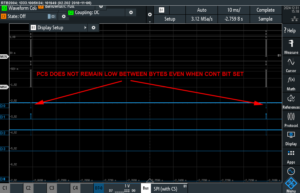

2) Function ReadFlashV2. Framesize set to 8 bits. JEDEC command sent as array of 4 bytes. The CONT bit (continuous transfer) not working, PCS never stays low, it always toggles high between bytes even when CONT used as described on page 2778 of the iMX RT1050 Reference Manual. How am I supposed to write or erase large blocks of data? Should I try disable hardware control of the PCS pin and set it up as GPIO? In this case I guess I would also have to handle PCS to CLK delays myself (using hardware PCS the API handles this already).

I have confirmed the second function 2) above works if I take over control to the PCS pin and set it up as a GPIO. In this case you would have to make sure you set appropriate delays between asserting and deasserting the PCS pin before and after clocks and between transfers etc.. the hardware LPSPI and API handles this if using the LPSPI modules kLPSPI_Pcs but in this case you are on your own.
I still want to know the correct way to use the CONT bit to allow continuous stream of frames while using the dedicated kLPSPI_Pcs?
