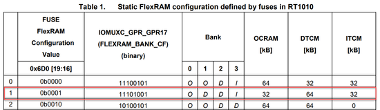

Habib_MS
Hi @expertsleepers,
If we look at the configuration of IOMUXC_GPR_GPR17 based on the app note that I provided to you, I can see that you have the following configuration:
However, keep in mind the following note:
Could you try another configuration that better fits the requirements of your application and complies with the note’s conditions?
Habib
11,545件の閲覧回数
expertsleepers
I will try that.
Could you explain though, why is the ROM requirement relevant? Since my application is already running when I change the FlexRAM, what ROM code would be running after that point?
I can understand that this would affect the boot loader if the FlexRAM was changed in the fuses. But I'm not changing the fuses - I'm changing the FlexRAM in software.
