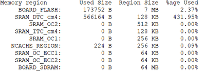

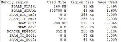

I am using imxRT-1176 EVKB and working dual core application. CM 7 is my primary core and CM4 is my secondary (slave) core. In my application CM7 and CM4 will have same code with shared memory. CM7 code is working fine but as i use the same code in CM4 the memory overflows. Help me in memory management so both core can work properly.
CM7 Memory mapping:
 CM7 build usage:
CM4 memory mapping:
CM4 build usage:

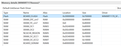

I suggest you can refer to SDK demo "evkbmimxrt1170_hello_world_secondary_core_boot_primary_core_cm7" and "evkbmimxrt1170_hello_world_secondary_core_boot_secondary_core_cm4"
For CM7 project:
For CM4 project:
Please double check CORE1_BOOT_ADDRESS setting in " the evkbmimxrt1170_hello_world_secondary_core_boot_primary_core_cm7"
Wish it helps you.

@mayliu1 I need more space to store my source code which is approx 4MB. and if i change the memory addresses and MCU linker then it doesnt work properly.
